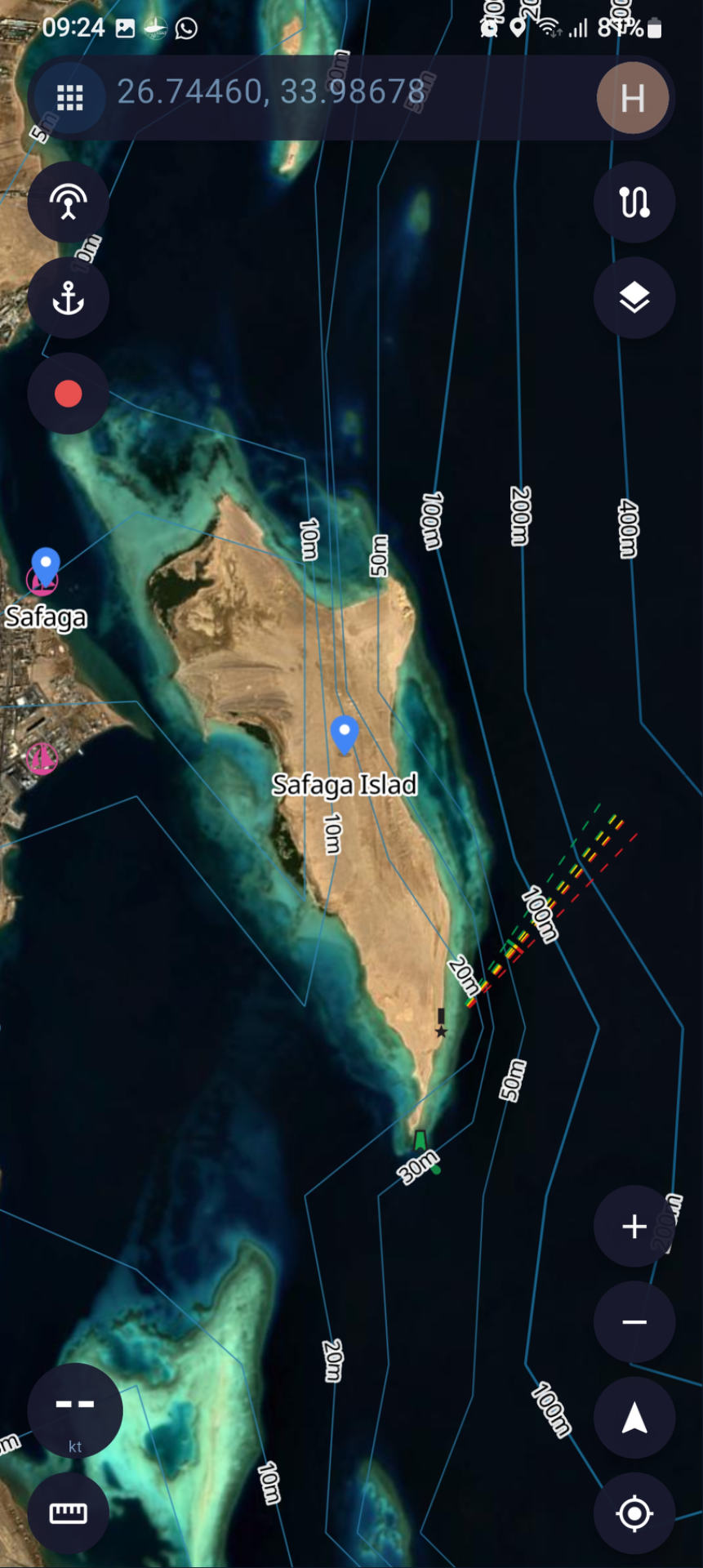

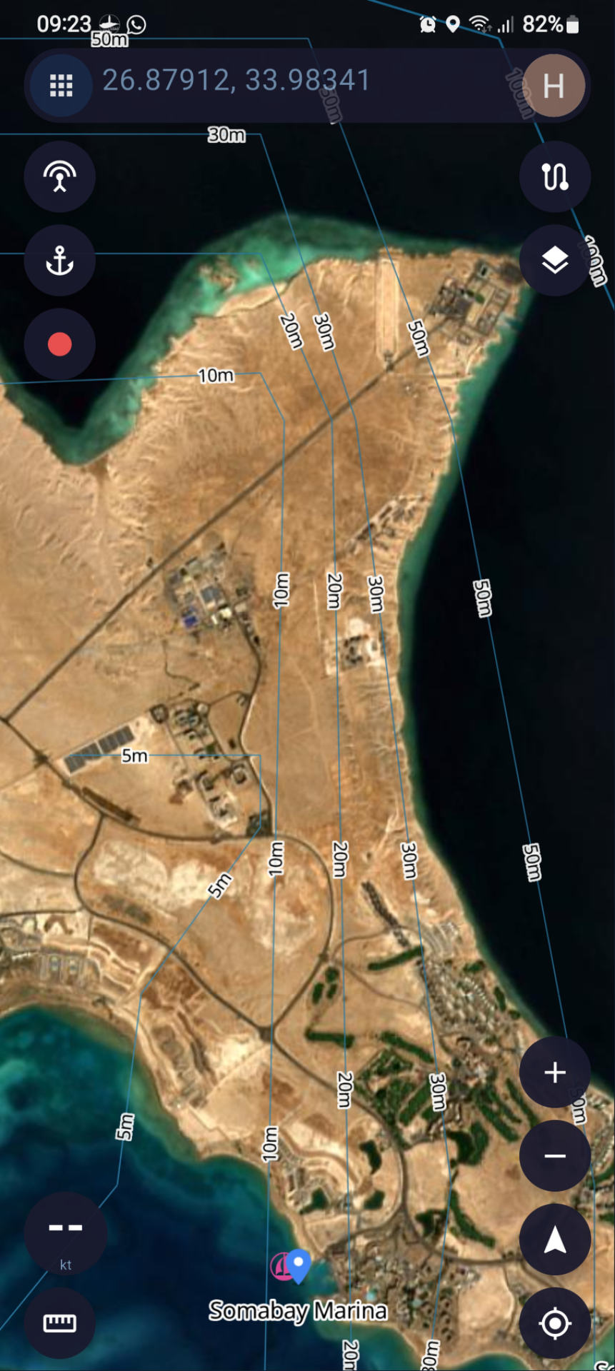

Hi me again , the new charts completely messed up the contour lines, see attached screenshots also the new text editor is gone??
Fotos und Videos
H Pro
Fotos und Videos

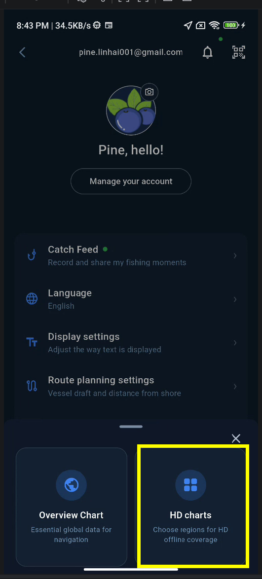

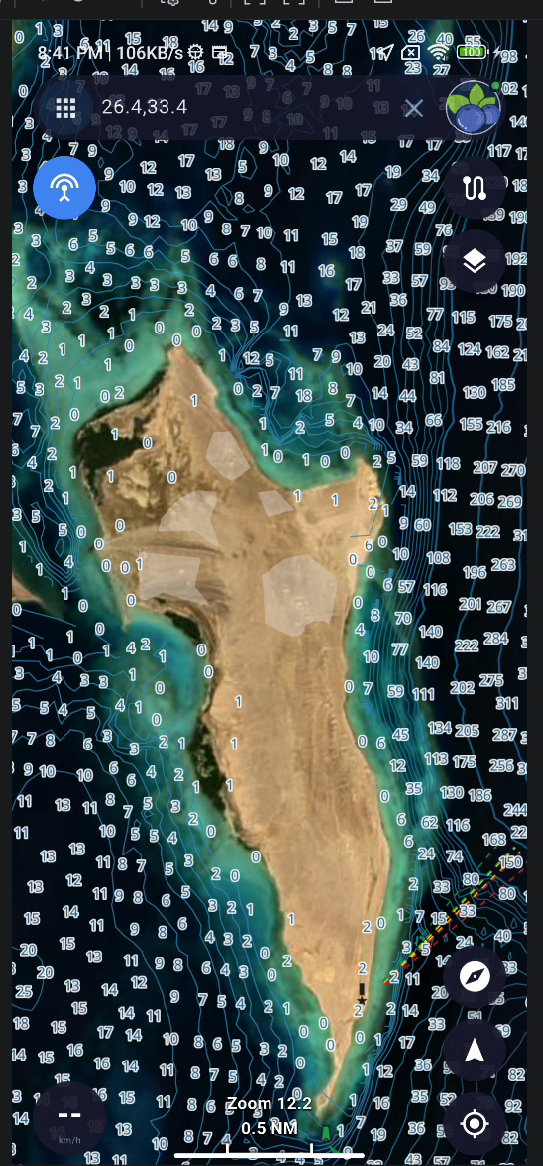

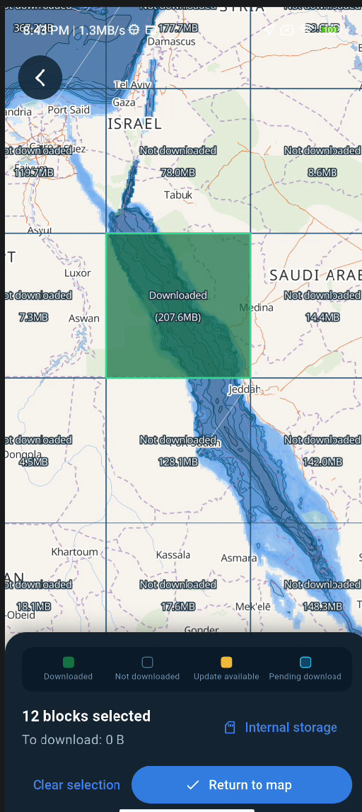

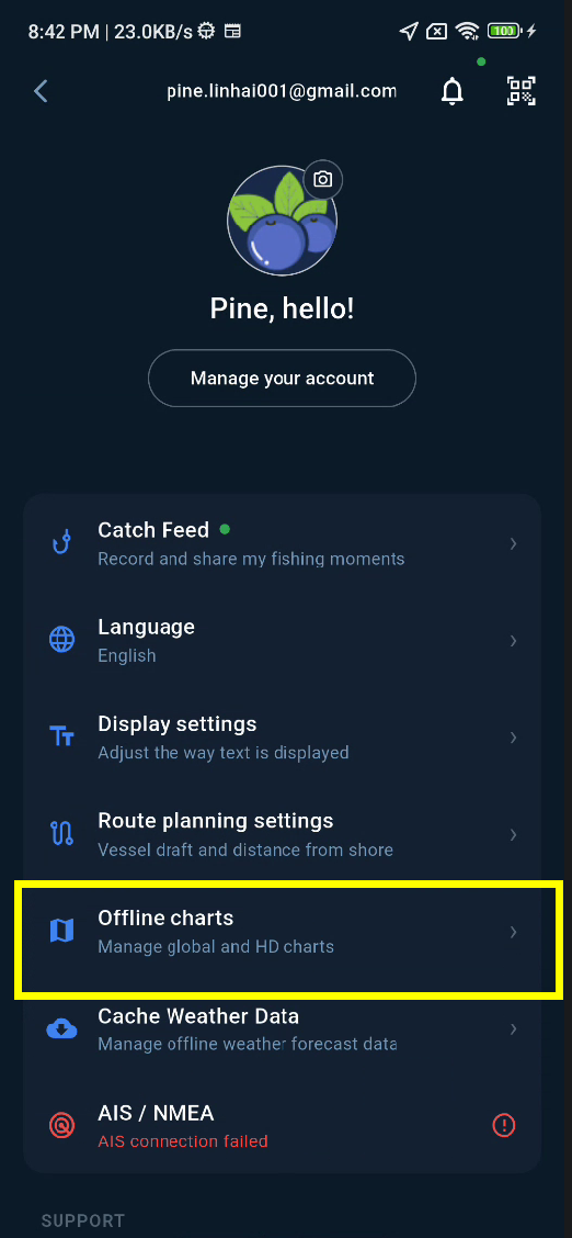

Hi again! I've recently updated the marine charts. Could you please follow the steps below to update your locally downloaded high-resolution charts? I suspect that the high-resolution charts for this area haven't been downloaded or updated properly, which might be causing the contour lines to display incorrectly. Could you please check whether the high-resolution charts for this area have been downloaded? Thanks for reporting this!
Fotos und Videos Fotos und Videos Fotos und Videos Fotos und Videos

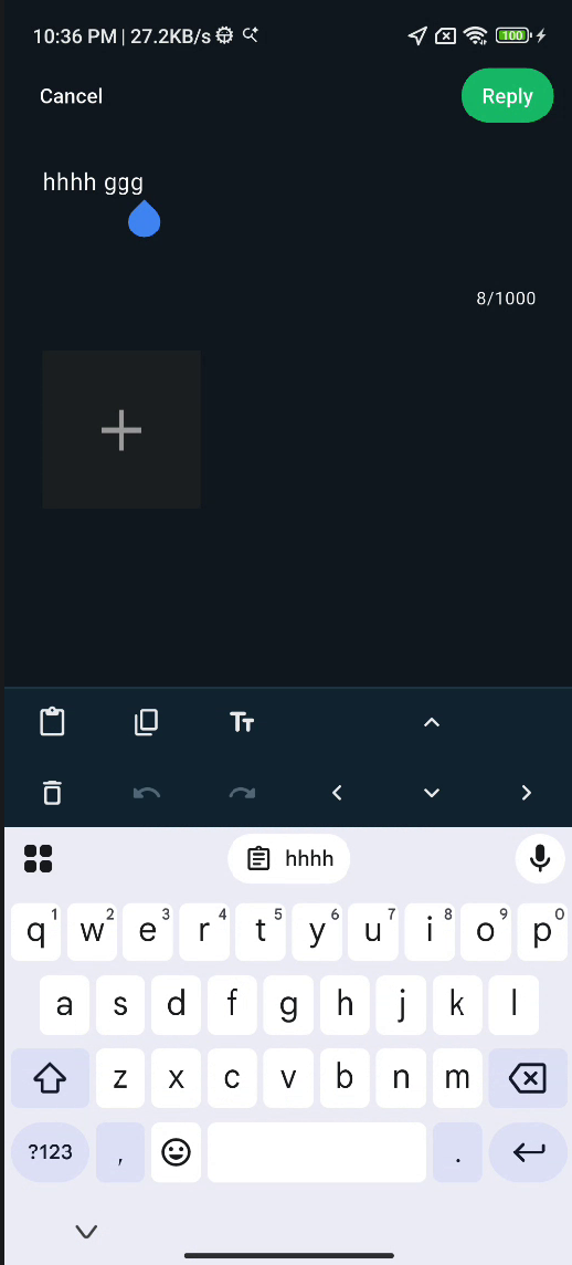

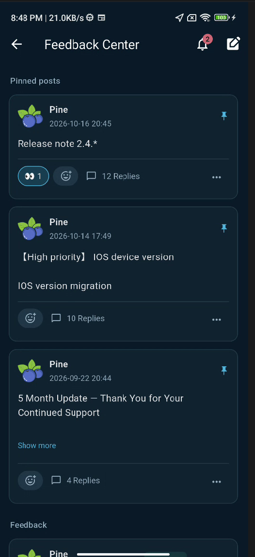

Regarding the text editor, I'm currently redesigning the Feedback Center UI and migrating the data from (feedback.aitinytools.com) the previous general feedback system to the new feedback structure(https://seachart.app/bbs?channel=feedback). During this transition, some UI elements and layouts may change, and certain features may be moved or adjusted. (Not Released) I apologize for any inconvenience and appreciate your patience and understanding!

feedback I removed the HD chart and reinstalled, same error I noticed that on your screenshot the size of the egypt chart is 200 mb, the chart downloaded on my phone is 119 mb, so there is an error in automatic selection somewhere the other thing is I have the previous version on my tablet 2.4.5 Ltd is working fine but it seems to have lost connection to the feedback back centre. my post from the tablet doesn't show on the phone and .y post on the phone and your response doesn't show on the tablet the other thing is the text editor. it is now a smaller box with no way to navigate
H Pro
feedback auto select only selected a small area of egypt based on my current location because I am currently in Cairo it completely omitted the red sea and Mediterranean I downloaded 5 blocks to cover egypt, download size is about 1GB

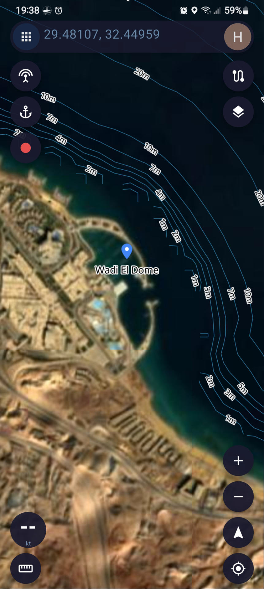

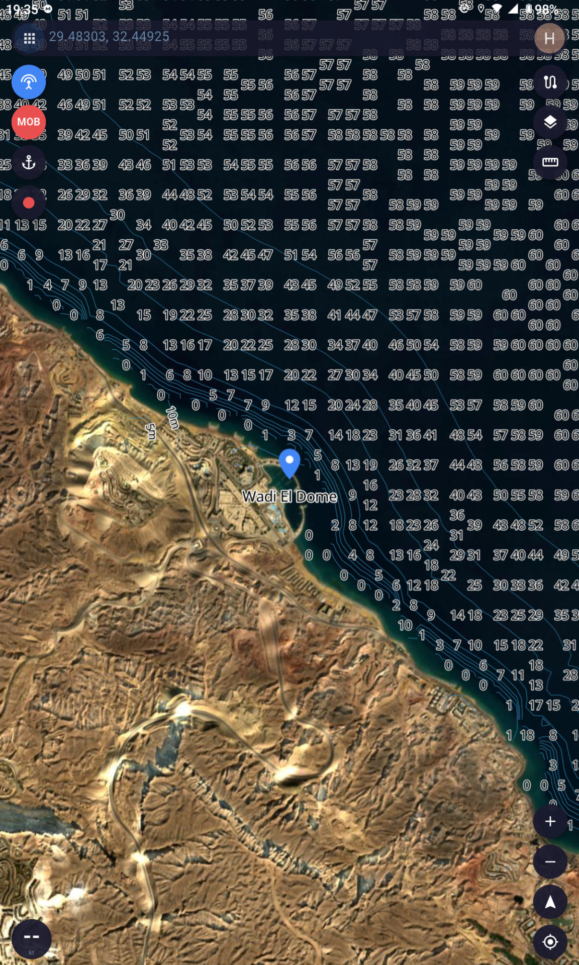

Feedback deapth error I checked the deapth in an area that I know quite well the deapth is not accurate I'll upload screen shots for a place called Wadi El Dome this is a large marina that accommodates big boats 30 meters + the deapth reading on the map is 0, 1, 2 meters outside the marina, that can not be accurate the points showing 0 and 1 meters are atleast 10 meters deep I suspect this is a source error or there is a significant drift
Fotos und Videos
H Pro
Fotos und Videos

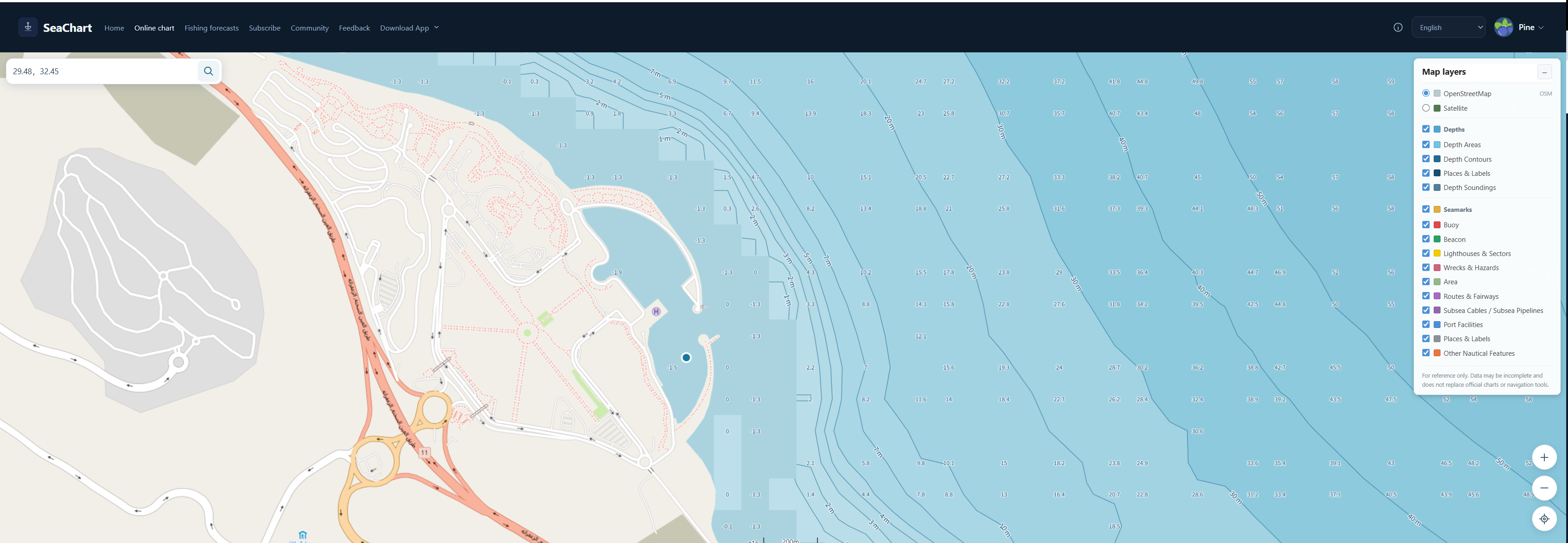

Thank you for the detailed feedback and screenshots. I've reviewed the Wadi El Dome area, and I don't think this necessarily indicates an error or positional drift in the source data. The issue is more likely related to the resolution of the depth data near the marina. The current processing logic selects the shallowest point within a sampled area. Since breakwaters and other coastal structures may be included in that area, the selected elevation can actually be above sea level, resulting in negative depth values. This means that even if the actual water depth is 10 metres or more, the displayed value may be 0–2 metres because the sampling area includes part of a breakwater or nearby land. So, from a processing perspective, the result is consistent with the current logic, although I understand that it can be misleading when viewing depths near marinas and coastal structures. I'll look into improving how these areas are handled to provide more representative depth readings. For now
Fotos und Videos
