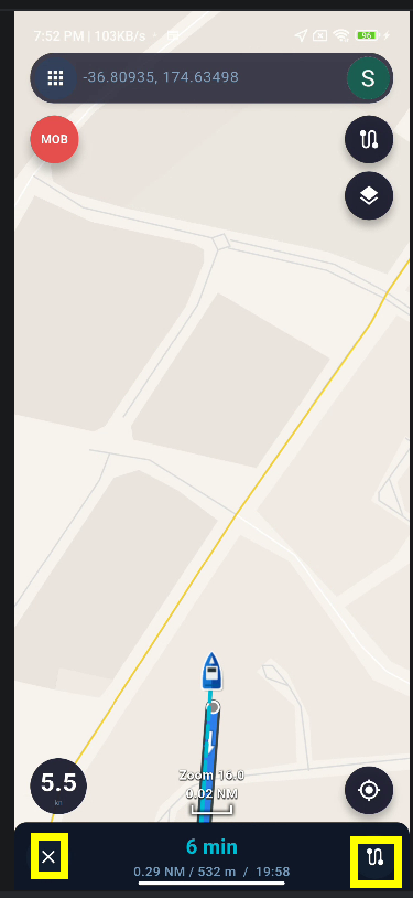

Thanks how do I exit the navigation mode?
You can exit Navigation Mode by tapping the close button at the bottom of the screen. Alternatively, you can tap the Route Overview button on the right-hand side to display the full route overview.
