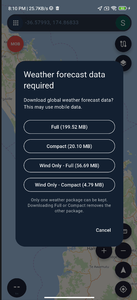

Thank you for your feedback. The new separated weather-data download feature has now been added. Weather data can be downloaded in smaller individual packages, allowing users to update only the types of data they need instead of downloading the entire detailed weather package each time. This feature is planned to be released in version 2.2.7 in early September. Thank you again for your suggestion and support.
Thank you very much for the fast response seperat data is an excellent solution In my use scenario, my main concern is wind, this should be a good solution for me and others Thanks again
Thank you very much for your feedback. Version 2.2.7 has now been released, and the separated weather-data download feature is included in this version. You can now download and update individual weather data types separately, such as wind, waves, pressure, and temperature, without downloading the entire detailed weather package each time.

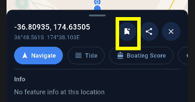

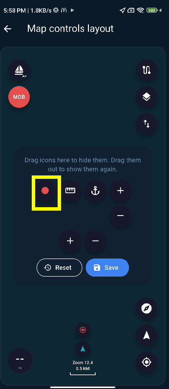

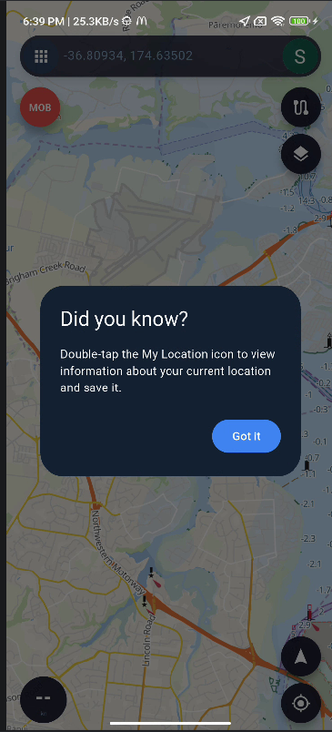

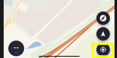

Greetings, and thank you for testing the new version. For quickly marking your current position, you can tap the **My Location** button in the bottom-right corner twice. A window will then appear at your current position, where you can choose to save it as a marker, as shown in the screenshot. Regarding the **Start/Stop Recording** action, this function is already available, but it is currently located among the hidden buttons. There is an issue with the movement and placement logic for hidden buttons in the layout editor, so this needs to be fixed before the button can be positioned correctly. I will address this issue in a future update. Thank you again for your feedback and continued support.

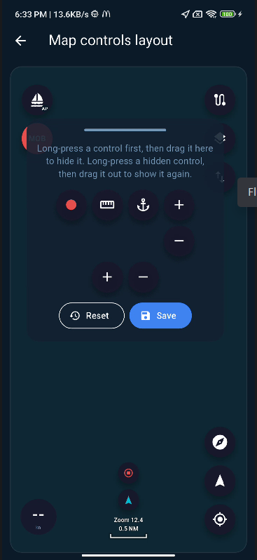

Regarding the layout editor issue you mentioned, I have tested it on several devices but have not been able to reproduce the problem so far. Could you please try the following steps first: **Press and hold the icon until you feel a vibration. Once the vibration occurs, you should then be able to drag the icon to the desired position.** I suspect the issue may simply be that the icon is being dragged before the long-press gesture has been fully triggered. If it still does not work after trying this, could you please record a short video showing how you are operating the layout editor and send it to [email protected] ? That would help me understand exactly what is happening on your device. Thank you very much for helping me investigate this.
I have also updated the wording in the interface to make the instructions clearer and hopefully avoid any misunderstanding. In addition, I added a small drag handle at the top of the window to make it more obvious that the window itself can be dragged and repositioned. Thank you for pointing this out — it helped me realize that the interaction was not obvious enough.

Thanks again I think I figured how it works It appears there are predefined drop zones but they are not delineated in the editor If I drop on top of an existing icon it briefly highlights the drop zone and accepts the icon If it is possible, can you make the drop zones visible in the editor, and also make the drop zones movable Thanks again and have a great day
